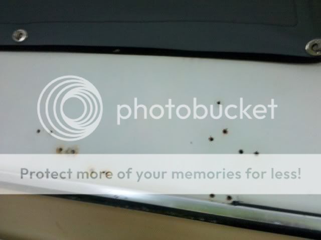

    Here are a few of the little buggers:
    And those aren't even the rusty ones!
    I've got 31....count 'em....31 of those stoopid little holes (one for each year the boat is old!) and that's just on the back! There's at least a dozen more here and there, half of them hidden by skateboard tape....
    Some have the gelcoat layer pulled out a bit and cracked by the screw that had been in there. Would it be advisable to run a counter-sink bit in them to 1) clean it out a bit and 2) give the patch material a better surface to bond with? Or am I going to have bits of gelcoat and fiberglass flying all over the place if I try that?
    As for the rust, I had to put a couple NEW holes in there for the fuel line and power cable for the kicker, so I picked a couple spots where the little holes looked the worst. That rust has permeated deep into the fiberglass. There's not going to be any getting rid of it with Bar Keeper's Friend or anyone else's friend, for that matter.... What are my paint options? Patch and smooth that area and just roll or spray some white over that and feather the ends at the boat's rear corners so it sort of blends in with the gelcoat?
    What a mess though! 31 freakin' holes....

    Looks like the same guy that drilled all the holes in my boat did your boat also. Or maybe they are from fiberglass termites....lol ......... I resin filled the holes sanded and going to paint over them. Simple easy and fast.
    On the smaller holes I made them bigger so I made sure they where filled propery.
